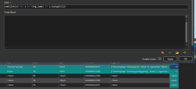

I'm having trouble reproducing.  Here were the field values I used:
[{"lamningstyp":"Fångstgrop","antal":4,"egenskap":"Bytesdjur: Älg/ren, Form: Rund"},{"lamningstyp":"Fångstgrop","antal":6,"egenskap":"Bytesdjur: Älg/ren, Form: Oval"}]
"[{""lamningstyp"":""Kolningsanläggning"",""antal"":1,""egenskap"":""Typ: Kolbotten liggmila, Form: Rektangulär""},{""lamningstyp"":""Husgrund, historisk tid"",""antal"":3,""egenskap"":""Verksamhet: Industri""},{""lamningstyp"":""Träindustri"",""antal"":1,""egenskap"":""Verksamhet: Såg/Sågverk""},{""lamningstyp"":""Kvarn"",""antal"":1,""egenskap"":""Typ: Hjulkvarn""},{""lamningstyp"":""Brott/täkt"",""antal"":1,""egenskap"":""Material: Lera""}]
[{""lamningstyp"":""Fångstgrop"",""antal"":4,""egenskap"":""Bytesdjur: Älg/ren, Form: Rund""},{""lamningstyp"":""Få"
In the field calculator:
sum([int(s) for s in !ing_lamn! if s.isdigit()])
Below is the result:
