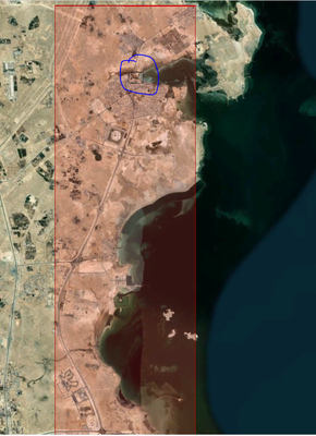

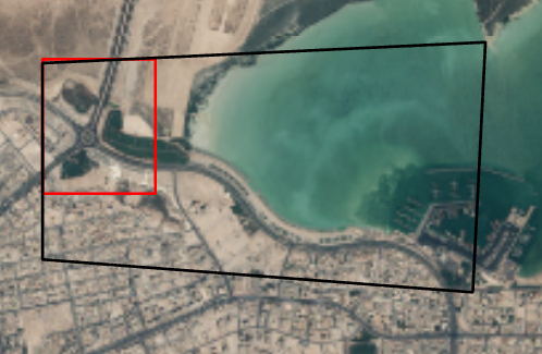

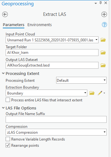

I am trying to extract an area of Interest (smaller area) out of the big las file. I created a boundary (tried different sizes) and use that while running the tool. However, it doesn't extract the entire area included within the boundary. Only a small section of it gets extracted. I have tried increasing the x-extent but it doesn't change the output. I have confirmed that both the layers are in the same coordinate system. I have also tried to have the processing extent same as boundary layer, didn't work. I have tried processing it in both map and local scene hoping for the right output.
The output is as below, the square in red within my black boundary.

I believe I know what's going on - the input point cloud parameter needs to be a LAS dataset or scene layer package (*.slpk).  Create a LAS dataset using the workflow described here and then attempt to extract the data again.  What is the result?

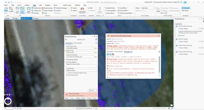

Hi I created a LAS dataset (.lasd format) and then am trying to use the Extract LAS tool and getting the attached error.
