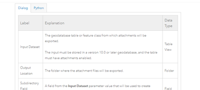

I am trying to extract attachments from gdb table. The script described in: How To: Batch Export Attachments from a Feature Class in ArcGIS Pro (esri.com), does not work for me on Pro 3.2. There are no python error masseges in the script preview, when trying to add the table i get an error, that table is not recognized as table (Error 000840 The value is not a Table).

Does this tool accept the table as input?
Export Attachments (Data Management)—ArcGIS Pro | Documentation
and if so, can it be used in batch mode?
Use batch geoprocessing—ArcGIS Pro | Documentation

Thanks Dan for suggestion. The issue was in parameter. I have to change it from table to table view, now it works.
