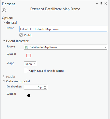

I would like to draw a leader from my extent indicator to the second map frame, but the option is greyed out. I couldn't find any documentation about why that might be. What do I need to change for this to work?

No, the extent is definitely smaller - it shows as expected on the map, no problem. I tried to remove the extent indicator but it keeps happening when I add it again. Weird thing is, I can add a leader by right clicking on the extent in the TOC, choosing "Remove leader" (which adds the leader). "Add leader" removes it. I can't change any properties though and it is still greyed out under "Element". Seems like a bug to me?

The issue for me was that Pro greys out the Leader options when one map frame has a Map Series enabled. This happens even if the extent of the second map frame is completely visible in the first. You can temporarily access the Leader options in the Extent Indicator menu by turning off the Map Series. After I had my leader preferences set, I was able to turn the Map Series back on with no issues.

I can confirm your theory that this issue is map series related. The key is applying a leader line to an Extent Indicator that belongs to the same map frame that is driving the map series.  Leader lines work fine when used with other map frames that are not driving the map series.
In my example below the Leader controls in the Element pane are disabled, however, you can still add a leader line from the Extent Indicator element context menu off the Contents pane (circled in green on the left side of the screenshot below).
However, you will still be unable to format the leader while the map frame with the Extent Indicator defines a map series.  You will need to set Map Series to None (it is not enough to disable the map series), set the line format, and then recreate the map series.
In my opinion the disabled state for the Leader in the Extent Indicator Element pane is a bug. Unfortunately, our test scenarios focused on Extent Indicators on other map fames and not the one driving the map series.  Thanks again for helping us identify a gap in our testing.
