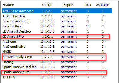

I converted 3D Analyst, Spatial Analyst, and Network Analyst extension licenses to concurrent.  I authorized them on my License Server Administrator 10.6.0.
I launch ArcGIS Pro 2.2.2 and the extensions aren't greyed out, but they are listed as not available.

As for your issue, can you go back to the Availability folder in the ArcGIS License Server Administrator.  click on the drop-down menu from Concurrent to Named User.  Do you have Pro named user licenses and/or Drone2Map?  If you have Pro Named User licenses, go ahead and reauthorize them with the .lic file now that you've upgraded your license manager.
BradJones3
I have already done this.  I had to reauthorize them because of the renewal of our maintenance.
