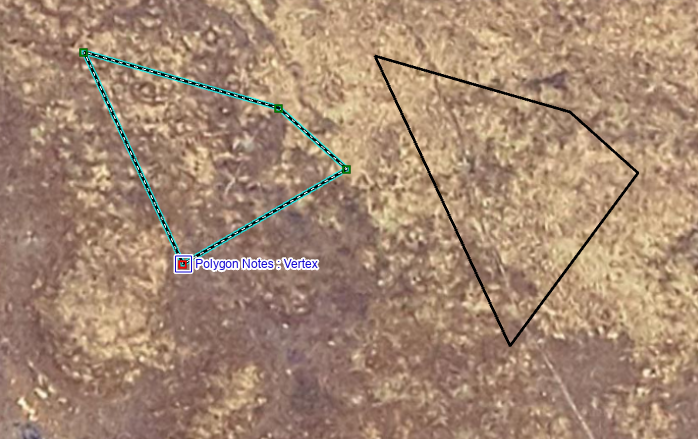

Is there an Editing tool that allows you to extend one side of an existing polygon by dragging a vertex to a new location but without deviating from its current direction? I see an Extend Length option in the contextual right-click menu but it's grayed out. Plus, I'd like to just drag rather than having to enter an exact distance, but have the edge constrained to its current direction (kind of like the Extend tool for line features).
Example:
In the example screenshot above, I want to be able to pull that selected vertex further south without deviating from the line's direction, and have the next segment adjust to the new location. I did this to create the polygon on the right by eyeballing it to keep it lined up with the original line's position, but I'm sure it's not EXACTLY the same direction. Is there a way to extend the side along its exact same direction?
The Intersection option in the Reshape tool is almost what we want, but it also extends another segment along its same direction, and that's not what we want. If we have to, we'll do that and then add a split step, but we're hoping there's a single-step option.
Can anyone suggest a tool we don't know about? (Note that we don't have Production Mapping.)

Hi Holly,
You can use the reshape tool with direction lock. Go to Edit tab > Modify features pane > select Reshape. Click inside the polygon and start to reshape. Snap the first sketch vertex onto the boundary corner before the one you want to extend. Right click the segment whose direction you want to maintain and click parallel. This will lock the drawing path to exact angle trajectory. Move you mouse as far south as desired along the locked line, click to place the vertex and then double-click inside the polygon to complete the modification.

Thanks so much for the detailed response! We'll give this a try. If it works for my colleague, I'll come back and accept your response as the solution.
UPDATE: That was exactly what we were looking for! Thank you!
