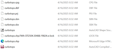

FMAGISFreeland
and 3.4
It does export fine, its just going to CAD

What is the source data type (service, file / enterprise geodatabase, shapefile, etc.?
What does the export file look like in file explorer?
Where is the output location: local / network share / etc.?

FMAGISFreeland
network share

Perfect, show that looks like a shapefile. I see all the components that make up the shapefile. See this for more details: https://desktop.arcgis.com/en/arcmap/latest/manage-data/shapefiles/shapefile-file-extensions.htm
My guess is that the 1 file extension is something that AutoCAD "could" use.
Does it show up as a shapefile in the catalog view in Pro?

FMAGISFreeland
It does show it as a shapefile in the catalog view, which is why I was even more confused when I saw it in explorer as CAD, specifically the .shx

George_Thompson
Esri Notable Contributor
I would not worry about that. My guess is that you also have AutoCAD installed on the machine and have the ".shx" file associated with AutoCAD as the default.
As long as it shows as shp file and works in Pro, you are good to go!
