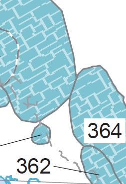

When I export a layout to a PDF in ArcPro 2.9.5 the fills in my polygons change.
What the fill is supposed to look like (paving pattern is white)

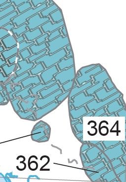

What it looks like when exported as a PDF in Pro (paving pattern is black)

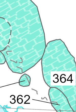

 What it looks like when exported to a PNG in Pro.

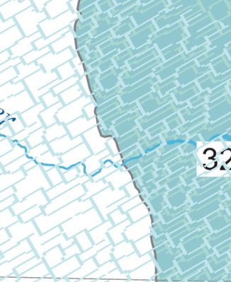

Thank you for the suggestions. When I select "Output as Image" it changes the display of my map and adds fill to areas of the map that shouldn't be filled.
In the legend:
 in a table:
 and the fill in the map changes and doesn't stay in the polygon boundary. (only the green area should be filled):
