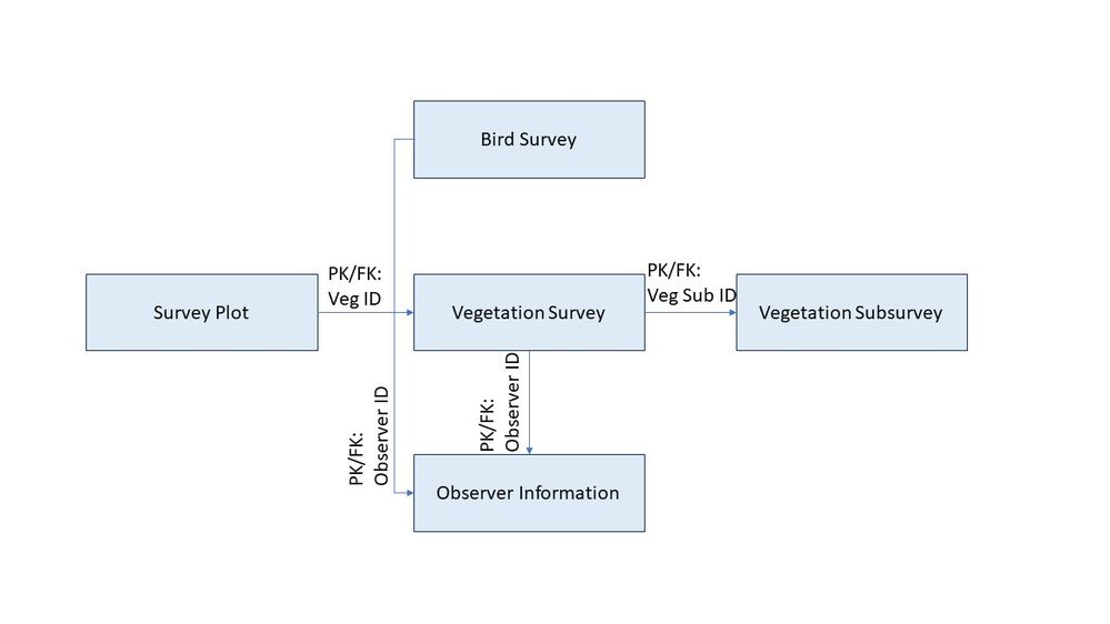

Hello everyone! I'm working with a geodatabase that consists of many tables linked together with relationship classes. I would like to export a diagram that shows the tables how they are related, something like this:
Having it export the exact connections would have the added benefit of helping me ensure I have all of the relationship classes I need. I've looked into ArcGIS Knowledge, and am looking into network diagrams, but I would be hugely grateful if anyone has any pointers for how to do this.

Hey @BeckB I dont believe there is this level of functionality currently within ArcGIS Pro, you can Generate a Schema report for you GDBs using the workflow here: Generate a schema report—ArcGIS Pro | Documentation
However that wont have a diagram, though it will list out the relationships within the GDB.
The only other method that may work is if the GDB is in a RDBMS like SQL Server you can create database diagrams within there, which should provide a similar output.
