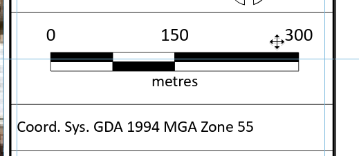

Since updating to Pro Version 2.7 last week all outputs (Jpeg, Png, PDF) are all missing graphic lines (feature ones are fine just those used for borders etc. I have searched but can't work it out.
Example 1: This is on the layout view - this is what we want as the output
Example 2: This is the exported view

We are aware that this affects lines.  We believe that graphics created programmatically, probably using an add-in, are the problem.  Graphics created via the UI are not. That is why the re-create and copy/paste work-arounds succeed.

We have many automated tests for ArcGIS Pro that import MXDs (of various versions) that contain graphics elements such as lines and rectangles. These tests all pass.  Debugging the issue points to the inclusion of properties for Z and M in the graphic elements in the Layout files provided by customers submitting the bug.
We are highly confident that graphics created through the UI (ArcMap and Pro) provide a different property set and that the problematic graphics were created through code (such as through an add-in). At Pro 2.7 very low level geometry changes were that invalidated graphics with specific Z and M property values. Unfortunately, we do not have many test cases of graphics created by add-ins and missed the bug.
