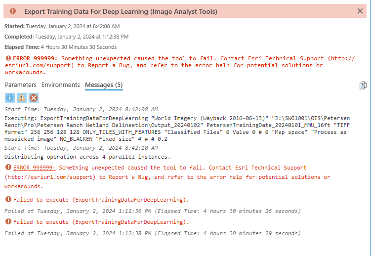

Hi all,
I'm getting an Error 999999 when I run Export Training Data for Deep Learning. It runs for hours, creates the folder structure, fills it with tiles and labels, creates the map.txt file, and then fails with no explanation:  "Something unexpected caused the tool to fail. Contact Esri Technical Support (http://esriurl.com/support) to Report a Bug, and refer to the error help for potential solutions or workarounds".
It does not create the stats.txt file or the esri_accumulated_stats.json and esri_model_definition.emd files that I believe it creates when it runs successfully.

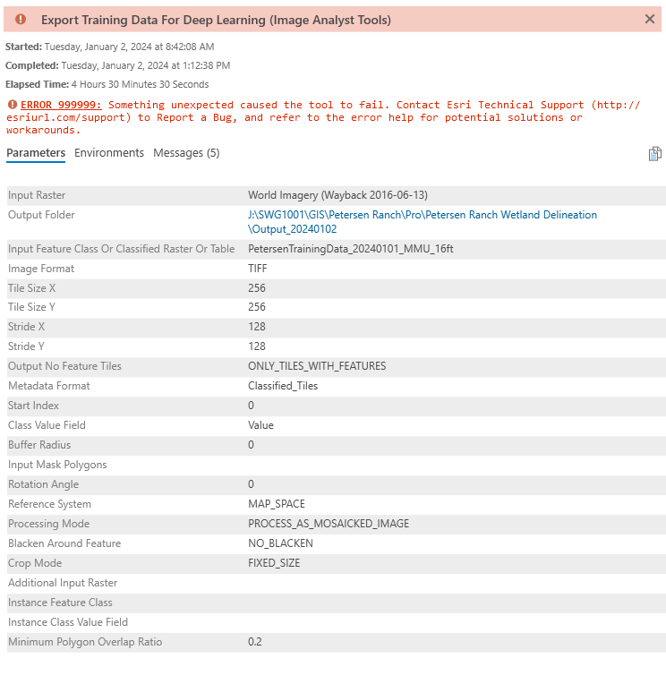

I have exported similar training datasets using the same exact imagery and parameters without error. The only difference I can come up with is that this is a larger training dataset and it covers several non-contiguous areas, whereas my previous training datasets were all contiguous features. I don't know why that would matter but maybe it does. I've tried it with polygon overlap ratios of 0 and 0.2 with the same result.
Here is the error:
Here are my parameters:
Here's the output:
Does anyone have any thoughts as to what could be causing the failure? Thanks in advance for any insight you can offer!
- Holly
