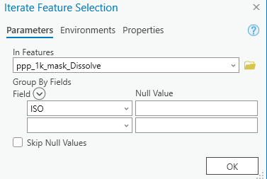

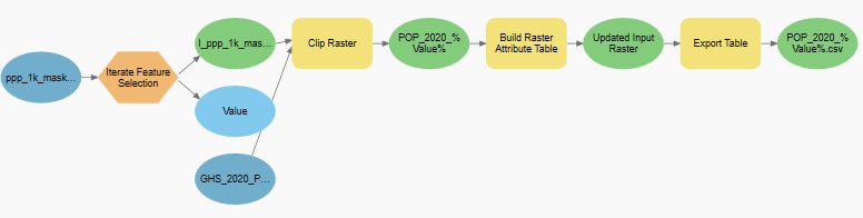

Hello! I'm new to GIS as a whole and I am trying to use it for some applications in my studies at university. Specifically I want to track the density of people and built infrastructure within countries over time.

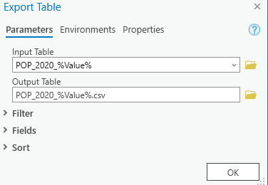

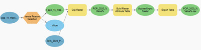

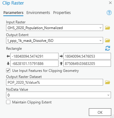

I've built a model where I clip the global raster by individual countries and then export the attribute table. The clipping part of the function works fine, but the issue I am having is that the exported raster table is missing data.

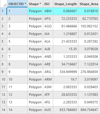

- Input polygons
- Raster sample

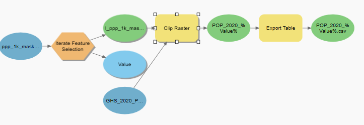

- Model
- Iterate feature
- Clip Polygons (Raster Statistics are turned on)
- Export Table
- Attribute table of iterated raster
- Resulting CSV
As shown above the resulting CSV is missing the 2nd and 3rd column of data. Is there something that I am doing wrong that is causing this issue? or is there perhaps a workaround for me to extract the data. Any help and advice would be greatly appreciated.

DanPatterson
MVP Esteemed Contributor
try Table To Table (Conversion)—ArcGIS Pro | Documentation
since all fields are exported
in Export Table (Conversion)—ArcGIS Pro | Documentation
it states
If the output is not in a geodatabase, BLOB or raster fields will not be included. GlobalID fields will be converted to text fields.

QuintinChua
Worked like a charm! Thank you so much.
KaustuvNeupane
New Contributor
Do you an image of model builder, which worked for you?
