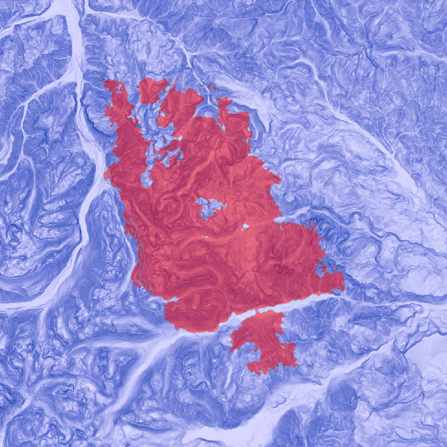

In the broadest terms, I am interested in modeling wildfire using deep learning.  To do, I have accessed fuel load and topological data from Landfire.gov (raster files), wildfire perimeters from geomac.gov (shape files), and wind and precipitation data from NOAA (flat text). I am trying to create numerical arrays of the terrain and fuel loads in the neighborhood of historic wildfires, which would be amenable to machine learning techniques.
I have successfully imported all data into an ArcGIS Pro project and map. An example fire looks this, with the fire above the slope layer of the Landfire data.  Very pretty!
I cannot figure out how to export or access this data at any level more detailed than a one layer .png
