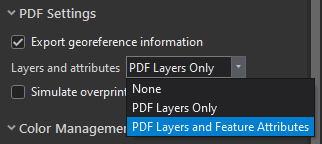

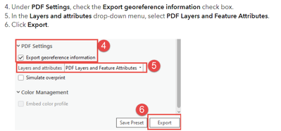

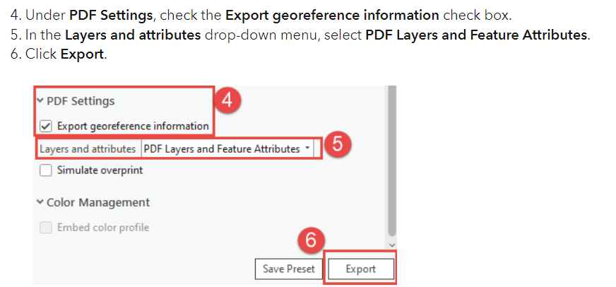

I am using ArcGIS Pro 3.1.3. I would like to export a layout as an interactive pdf.
The ESRI support article - https://support.esri.com/en-us/knowledge-base/how-to-export-a-map-as-an-interactive-pdf-in-arcgis-pr... - says to check the 'Export georeference information' box, and select 'PDF Layers and Feature Attributes' from the 'Layers and attributes' drop-down menu - see screenshot below.

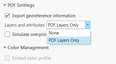

However, when I try and do that on my version of Pro, I see no such option on the drop down menu - see screenshot below:
Does anyone have any ideas of what is going on here?

Hi @YusefSamari
The "PDF Layers and Feature Attributes" option is not available when the "Include accessibility tags" option (under the Accessibility tab in the Export pane) is checked. Unchecking this option should enable "PDF Layers and Feature Attributes" option.  See the thread Export attributes to PDF for more information.

After looking at this closer, are you choosing to "Export Map" from the ribbon while viewing your map, or are you choosing "Export Layout" while viewing the map's layout?
YusefSamari
Thank you for highlighting that! I misread the article. I have managed to export the map as an interactive pdf now, but it does not include any kind of legend. Is there any way to get a legend showing symbology on there?

Thanks so much! I toggled 'Export georeference information' on the Export Map tab, but the 'PDF Layers and Features' option still wasn't appearing in the drop-down menu on the Export Layout tab, probably because of the 'Include Accessibility Tags' option was checked as Tom mentions below. However, this worked anyway, and even with selecting 'PDF Layers Only' it still exported a pdf with switchable layers and a legend.
TomBole
Hi @YusefSamari
