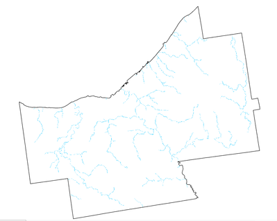

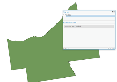

im trying to calculate Eucledian Distance with a Raster Dataset. Its basically a river network which i extracted from the DEM. Whenever i run the tool, i dont get the distances but the whole are just fills up with one color.
Can someone help me how to fix this?

This is exactly the problem, 0 is still a value.  You need to change it to NODATA then re-run the Euclidean distance with that new layer.  I'm sure it will work as intended then.

Can you share a screenshot of flow_recl1 ?  When you click on a few pixels of the euclidean distance result and flow_rec1 what values do you get?
To me it just looks like you've set the other raster cells in flow_rec1 to no symbology rather than actually reclassifying the data https://pro.arcgis.com/en/pro-app/latest/tool-reference/spatial-analyst/reclassify.htm.  What are the cell values of 1 in the screenshot?
This would explain the Euclidean distance result, as the tool doesn't care about how you symbolise the input data.

what's the cell values of 1 on flow_rec1?  can you change that symbology to a colour rather than blank?
furry_ferret
that was the setup. 0 = 0-4400 and 1 = >4400

It worked! Thanks alot 🙂
