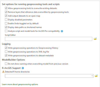

save the project to a local disk and set your environments to overwriteOutput as True

I have done that and still running into errors- now it is the following:
ERROR 999999: Something unexpected caused the tool to fail. Contact Esri Technical Support (http://esriurl.com/support) to Report a Bug, and refer to the error help for potential solutions or workarounds.
The operation was attempted on an empty geometry.
The input feature classes are definitely not empty.
What is the best way to trouble-shoot this?
Marie
Finally managed to make this work by changing the output file names. Are there restrictions/limits on output file names?
