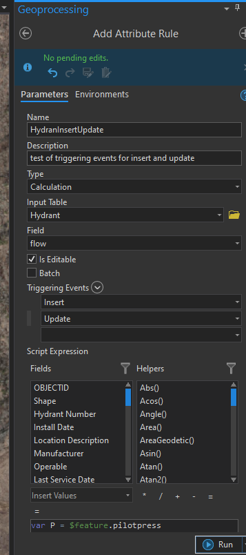

I am helping our city Fire Department to conduct fire hydrant inspections. One of the inspection steps is to take several readings (static pressure, residual pressure and pilot pressure) from the hydrant to determine flow gallons per minute (GMP). Typically, they would take these readings and have to put them into a third-party program that then does the calculations to in the background to get GPM.
I have an Arcade script that will allow the GPM to be determined in the field once the required numbers are input in the appropriate fields. I have run script in Pro with no problems. I wanted to add an attribute rule with a triggering event of 'Update' and  'Insert' so when they either go to an existing hydrant or add a new one and conduct a flow test the GPM will be calculated on the fly.  It runs as expected on existing hydrants. However, when I try to add a new hydrant I am receiving an error. Any guidance would be greatly appreciated! Please see error message, script and set up of geoprocessing tool below.
ERROR MESSAGE:
ARCADE SCRIPT:
var P = $feature.pilotpress
var S = $feature.staticpress
var R = $feature.respress
var Q = 167.0625 * Sqrt(P);
var RF = Q * Pow(((S - 20) / (S - R)), 0.54);
return RF
GEOPROCESSING TOOL SETUP:

Hi Ari Lukas ,
The moment you submit the new feature, do you have values in the fields pilotpress, staticpress and respress? If not you will be performing the calculations with null values. It would be better to include a validation that checks if the values are null and avoids performing the calculation when not all values have been specified yet.
Can you try this expression?
// function to validate if any of the values have not been set yet
Function ContainsEmptyValue(arr) {
    var validation = False;
    for (var i in arr) {
        if (IsEmpty(arr[i])) {
            return True;
    return validation;
// read values
var P = $feature.pilotpress;
var S = $feature.staticpress;
var R = $feature.respress;
// validate values
if (ContainsEmptyValue([P, S, R]) == False) {
    // all value are available, calculate Q and RF
    return RF;
} else {
    // one or more values havve not been set, return null
    return null;

AriLukas
Hello Xander,
Thank you, that worked like a charm!!
