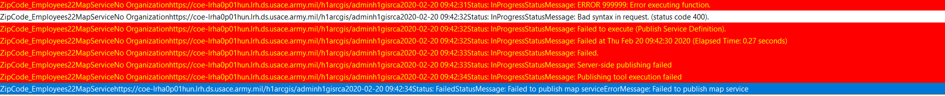

I am getting an error message when publishing a server to from Pro 2.4.
The error message I am getting in Pro is:
   InProgressStatusMessage: ERROR 999999: Error executing function.
   InProgressStatusMessage: Bad Syntax in request. (status code 400)
   InProgressStatusMessage: Failed to execute (Publish Service Definition)
   InProgressStatusMessage: Failed at <Time>
   InProgressStatusMessage: Server-side publishing failed
   InProgressStatusMessage: Publishing tool execution failed
   FailedStatusMessage: Failed to publish map serviceErrorMessage: Failed to publish map service
