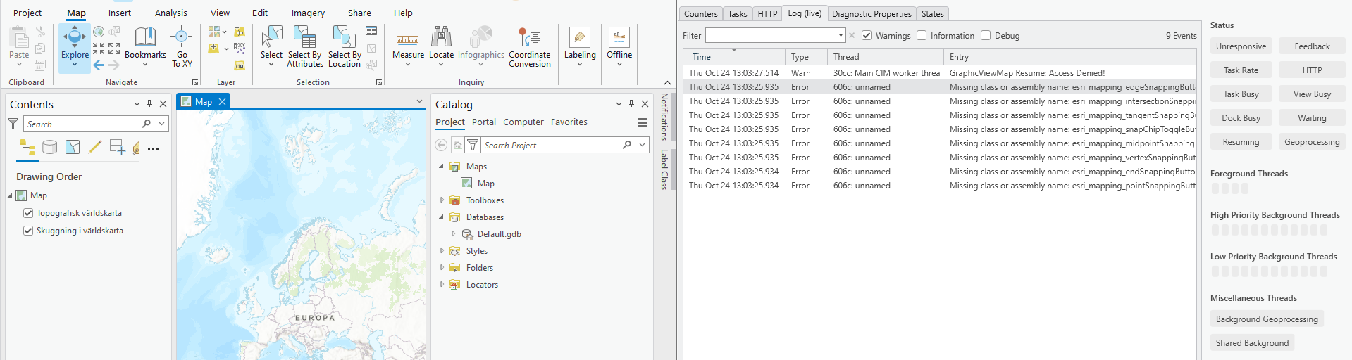

Can you let me know why does we have errors in diagnostic monitor, steps to create are as follows:
--> Start ArcGIS Pro with /enablediagnostics
--> Open project without template
--> Add map
and once the map is loaded then we see the errors in diagnostics monitor :
Missing class or assembly name: esri_mapping_edgeSnappingButton
Missing class or assembly name: esri_mapping_intersectionSnappingButton
Missing class or assembly name: esri_mapping_tangentSnappingButton
Missing class or assembly name: esri_mapping_snapChipToggleButton
etc [Attached screenshot]

I also have this error message and would like to know what it means. I have a Brand-new laptop and I'm trying to diagnose why it takes so long to draw my aerial now compared to my old laptop.
