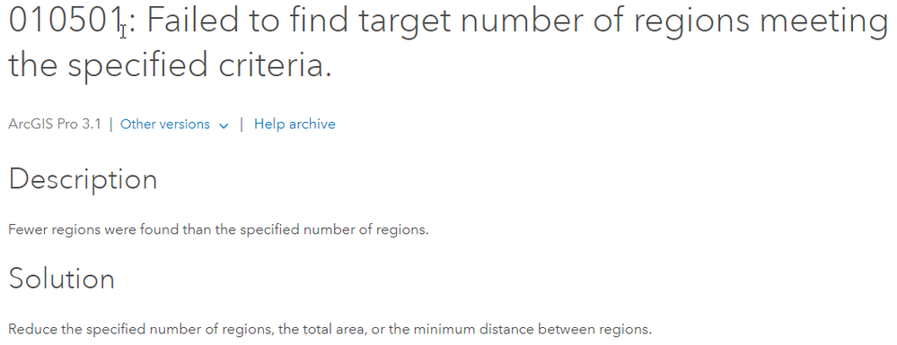

What version are you using and a screenshot of your suitability map showing min and max would help.
And, have you tried the solution associated with the error?

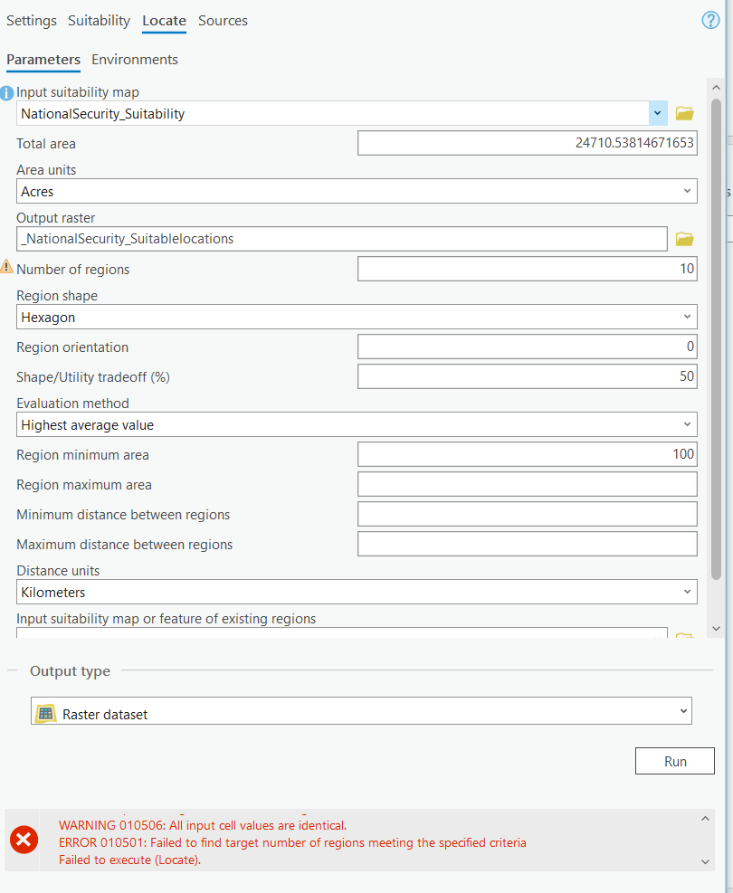

Thanks so much for replying. I am using ArcGIS Pro Version 3.1.2. For some background, I am trying to use the suitability modeler to site aquaculture in ocean waters. I will eventually have multiple submodels, but right now I am just trying to do the first submodel (national security constraints). I have already taken out all of the areas that are completely unsuitable for aquaculture (would have 0 suitability) and created a layer that contains all of the potentially suitable area called "Final Study Area Albers". I have clipped all the rasters for the suitability model to this layer. The four layers that will be in the national security submodel consist of various naval, military, and air space use. I am trying to find areas within the Southern California Bight that are 100-1000 acres in size, and I want to find as many areas as possible within each submodel so that when I combine the submodels there will hopefully still be some areas to choose from. Since I posted this, I have tried reducing the specified number of regions and the total area (minimum distance between regions has been left blank). However my goal is to find as many suitable areas as possible of this size and its not allowing me to do that. Here is a screenshot right after clicking "run" the suitability pane:
Here is the result of the failed run in the locate pane:
The total area was left at the default 10% of input cells, minimum size was set at 100 acres. Then if I try to just find 1 region, and play with the total area, I still get the same error codes. So I feel like it must be something with the warning "all input cell values are identical" but I'm not sure what that means. Or maybe I'm misunderstanding how to use the tool. Any help would be appreciated! Thank you!
SteveLynch
The problem that you are encountering is that your suitability map is all zero, hence WARNING 010506: All input cell values are identical.
The Suitability Modeler does not use 0, I suggest that you use the Environment's Mask or set areas that you don't want to use to NoData.
Does your suitability map, when using only 1 criterion, have different values and can you run Locate on it?
