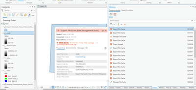

Hello everyone,
I'm trying to publish a web elevation layer from a tile package to use as a custom elevation layer in an Experience Builder profile widget.
I followed the steps indicated in this post:https://pro.arcgis.com/en/pro-app/latest/help/sharing/overview/tile-package.htm#GUID-853C5B89-8C83-4...
However, I did not succeed in exporting the tile cache as a .tpk file.
I received this error: ArcGIS Pro Tool Error 001485. https://pro.arcgis.com/en/pro-app/3.3/tool-reference/tool-errors-and-warnings/001001-010000/tool-err...
I already tried using a different folder, but it still isn't working.
Thanks!
ScottGIS
Did you resolve this issue? I am getting the same error, and can't get around it after trying several different folder locations.

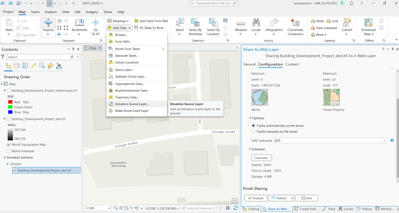

Hi @ScottGIS
I resolved this by adding my data as an elevation layer in ArcGIS Pro, which automatically enabled the LERC option when I clicked to share:
