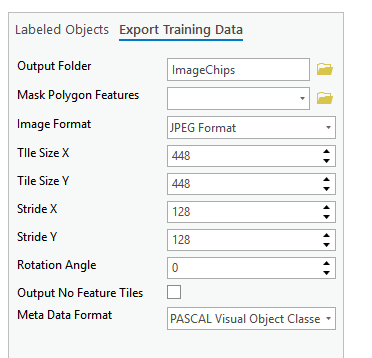

Try to reduce the tile size during the exporting and batch size during the training.
For example:
If you are working on tile size 448 as mentioned in below figure try to reduce it 50%

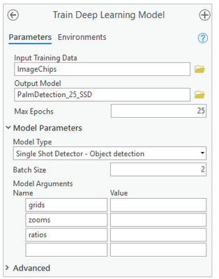

Secondly, at the time of training the dataset please reduce the batch size is 1 if you worked on 2 or 4 as mentioned the below figure.
If still, you will get the same error, kindly check the GPU usage and assign complete GPU for ArcGIS Pro. and Check the python libraries, uninstalled the fast.ai and install the fast.ai and try.
For example:

Actually when you gave your advice and reccomendations I was formating my laptop and reinstalling the Arcgis and frameworks. But the problem countinued the same. So, I did what you suggesting (reducing the tiles size) and now it's running "normal" and I could did several tests.
