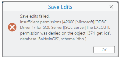

Hello all!
Could anyone possibly add some insight or direction as to how fix this error message.
Thank you in advance for any help!
AyanPalit
@BrandieHegler More context will help. From the screenshot, I assume you are using ArcGIS Pro to edit and save features stored in an enterprise geodatabase (eGDB) using SQL Server.
  • If the eGDB was setup by GIS admin, consult them if you have permissions to edit and using the right credentials.
  • If you are the admin and setup the eGDB, check if the right privileges were granted.
Privileges for geodatabases in SQL Server
