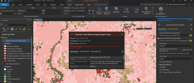

I have tried to use the Trend analysis in ArcGIS Pro to generate a trend raster using Global Land Cover 1992-2019 but I got this message:
ERROR 160224: The application is not licensed to edit this type of data.
Please, could you help me to understand why and how can I solve it?

It is a Subscriber Content, i.e. you need an organizational account to access the data. You seem to have that too.
Try this out.
1. Close all ArcGIS Applications.
2. Restart ArcGIS Pro.
3. Add the Global Land Cover from ArcGIS Living Atlas.
4. Add your area of interest, if any. Else zoom-in to an area of larger scale.
5. While executing the "Generate Trend Raster" tool, please ensure you are defining a the processing extent (Tool Environments).
*For me, it worked fine for a map scale at 1:1,000,000 (Processing extent: Current Display Extent).

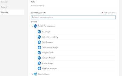

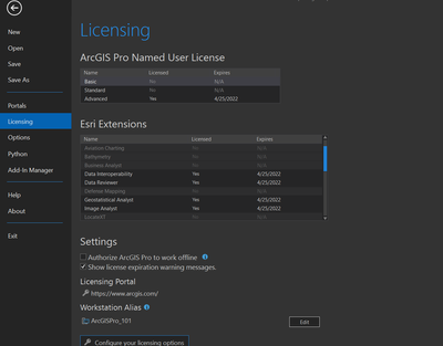

Please, kindly see the screen shot below, do I have the Image license for your ArcGIS Pro client? Or these extensions are for add-on license which means that I do not have them yet?
George_Thompson
Esri Notable Contributor
Looks like you have the extension license you need. Where is the data coming from?
I wonder if there is some sort of  data restriction. You may need to contact technical support on this.
--- George T.

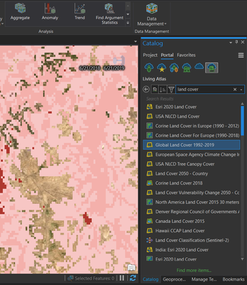

I took the data from Living Atlas using imagery layer:  Global Land cover 1992-2019.
Is it free? if not so, please, could you provide me the contact or link that enables me to reach out the technical support.

NadaKadhim
Everything was ok. I just have not considered the Environments tap. I should select the "current extent" option in the processing extent field.
Thank you, Jayanta.
