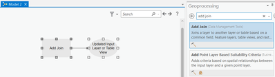

I get this error in Pro, ModelBuilder. I am not doing anything with domains. I can successfully create a Join in my map and then drag the Add Join from history into modelbuilder. I remove the join in the map and run the join in modelbuilder. This error comes up and I have no idea what it is about. Has anyone else seen this behavior? If I leave Pro and restart it, this error may or may not go away. There is no reason for this.

Did you try adding a fresh Add Join tool from the Geoprocessing pane, rather than from History?

I have tried recreating the join from tools and also from history. This seems to be an intermittent error and just a scratch on the surface of many issues with ModelBuilder.

Thanks for this tip. I was having the same error described in this post using Join Field from the Geoprocessing tab (not model builder), and starting from a fresh instance of the tool rather than double-clicking it in my history resolved the issue for me. I suspect the issue with the History version of my tool is because I had gone back to the source table and changed the data type from String to Long because otherwise my join was only bringing in Null values, so it must be caching something to do with the join field's type in the history of the tool and using a fresh instance of the tool means that cached information isn't referenced.
