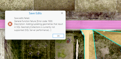

I am experiencing similar issues when trying to reshape polygons in a Hosted Feature Layer using the Align Edge tool. I have gotten a couple different errors which I will try to capture and add, but most of the time I see this error:

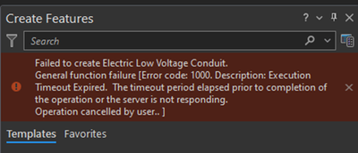

I am receiving this error when editing a layer hosted in AGOL within ArcGIS Pro 3.3.2.

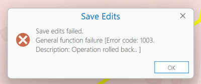

I am receiving the error when I try to split, copy parallel or create new features. After I receive the error most times i resubmit and then it goes through. Any one else having these issues? ArcGIS Pro 3.3.1
