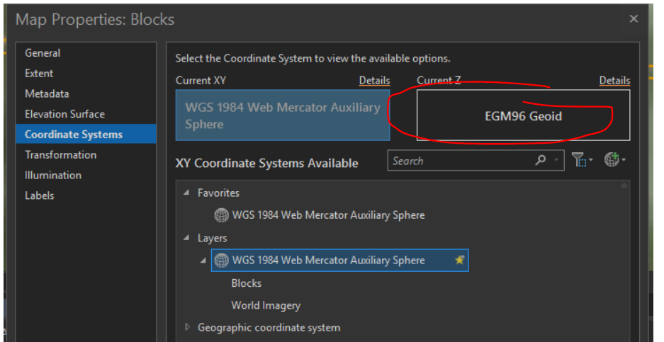

I created the *.prj file by saving the coordinate system of my world imaging and using the"Project" arcpy tool. Coordinate system menu
Above is a picture of the properties of my map. You're saying that while the coordinate systems agree in the window, that might not be true?

Maybe something to do with z?  This isn't default:

After some monkeying around with the webmap publishing function it seems to be working (with the settings in the picture I linked). I'm not sure what exactly I did but as far as I can tell after I successfully published a different, non-related webmap the original map in question was able to upload (no settings changed). The Z coord system isn't causing any problems, as Kory suggested was possible.
