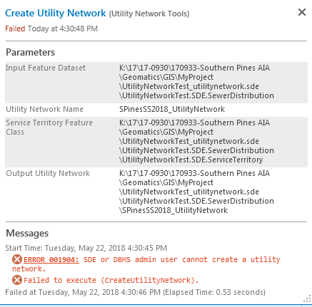

Hi! I am getting the same error [Error 001904] after running 'Create Utility Network' tool. Though I was able to create a new user using 'Create Database User' as suggested by Abhijeet, I am still getting same error [Error 001904] after running 'Create Utility Network' tool again. I am so stuck!! Any other suggestions on this issue will be much appreciated. Thanks!

Can you please share screenshots of steps during 'create database user' and 'create Utility Network' tool?
Also please let us know the PRO version you are using e.g. 2.1.2 or 2.1.3 or any other.

Thanks for getting back to me. I am using ArcPro 2.1.3 and SQL server Express v17.7.
Below is the screenshot of settings that worked fine for Create Database User. Though when 'Create Operating System Authenticated User' box is checked, it asks for an existing user.
I tried to uncheck 'Create Operating System Authenticated User' box and tried to run this tool again to create a new user and this worked fine too. Below is the screenshot:
I tried to run 'Create Utility Network' tool before and after creating a new user, but getting the same error:
