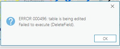

I am currently implementing some attribute changes to a layer (Traffic Collision) within a geodatabase. I have been trying to create a new field so I can fill the new field with information I will copy into it, but trying to create a new field leads to the "ERROR 000496: table is being edited. Failed to execute."

The issue, however, is that I have no current active edits on this layer and if I try to start making edits to the attribute table to resolve this error, I get another error:
"Update table row failed:[LAYER] Unexpected operation [LAYER]
What stumps me about this issue is that, I cannot delete or make changes to the layer without one of these errors appearing. LACo_CityBoundaries is another layer found within the same Geodatabase that my layer of focus is in, but they are in different Feature Datasets. There are no active edits with either layer going on, and I am finding a hard time finding why an unrelated layer would prevent me from making intended changes to another.
