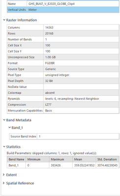

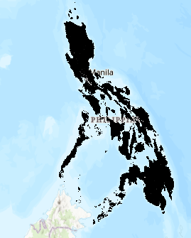

Hello! I'm trying to find out the total amount of build volume within a country. I have a global dataset which I am cropping using polygons for national boundaries.
Clip Info:
Visualization:

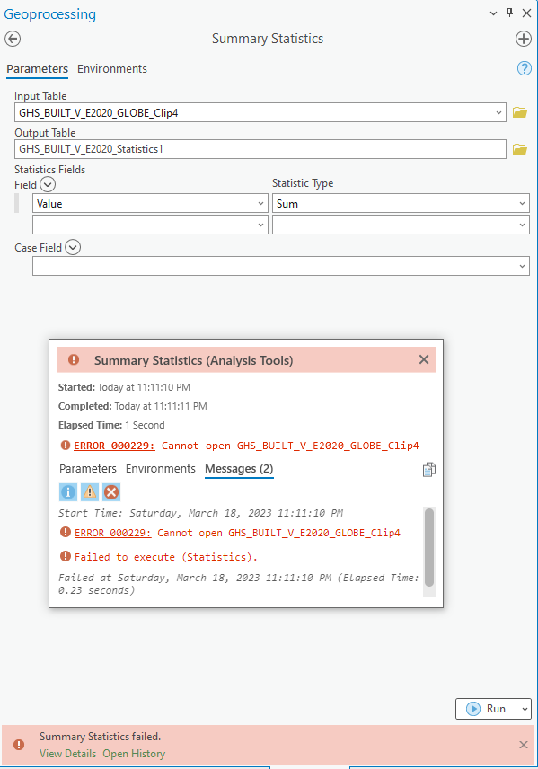

The issue is when I try to find the sum of values in the band using the Summary Statistics tool I receive ERROR 000229.
Is there some mistake that I am making? or is there perhaps a better way of doing this? any help would be much appreciated!
Additional info:

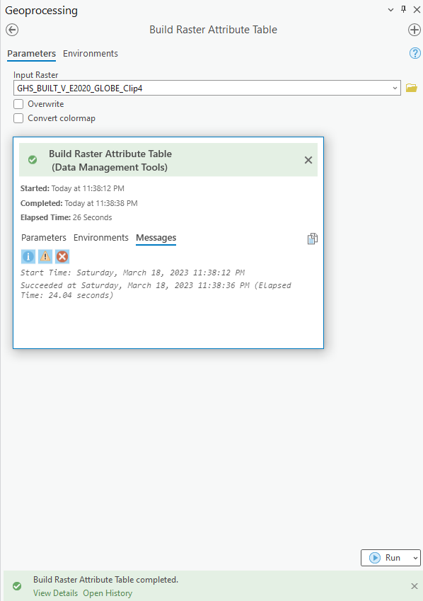

The attribute table is grayed out. I've tried using the build raster attribute function, while the task completes successfully it does not create an attribute table, or if it does I cannot locate it as the attribute table symbol is still grayed out and ctrl + t does not seem to do anything.

For output table, try using the folder icon to the right of the line, navigate to a folder and specify an output name with a *.dbf file extension.
The reason you can't locate the output is that the tool supports the current and scratch workspace which you may not know what or where it is
