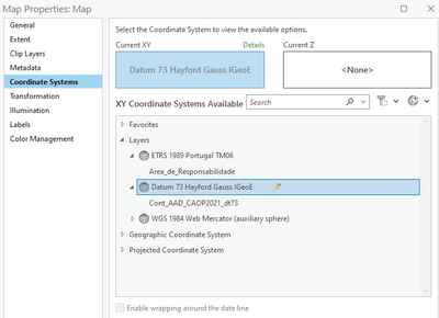

Hello
I'm working with data in different coordinate systems, but the option "Enable wrapping around the data
line" always appears disabled. Can you please help me understand why?
Thanks
DanPatterson
MVP Esteemed Contributor
It is only supported for some projected coordinate systems
