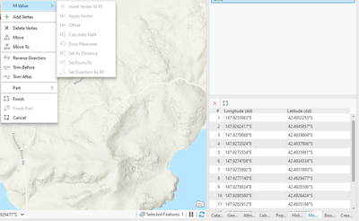

Hi all,
I have imported some polyline data and plan to use linear referencing. However, I cannot find M value nor can i edit it.
Can anyone help please?
If useful - I have version 3.0.4 ArcGIS Pro installed.
Cheers

untried, but in theory should work
create an empty featureclass ensuring that you m-enable it.
use the Append tool to append the records from the other polyline to it

I realised that I should try turning the lines into routes. It now works.
The function I used is "create routes". thanks for your reply!
