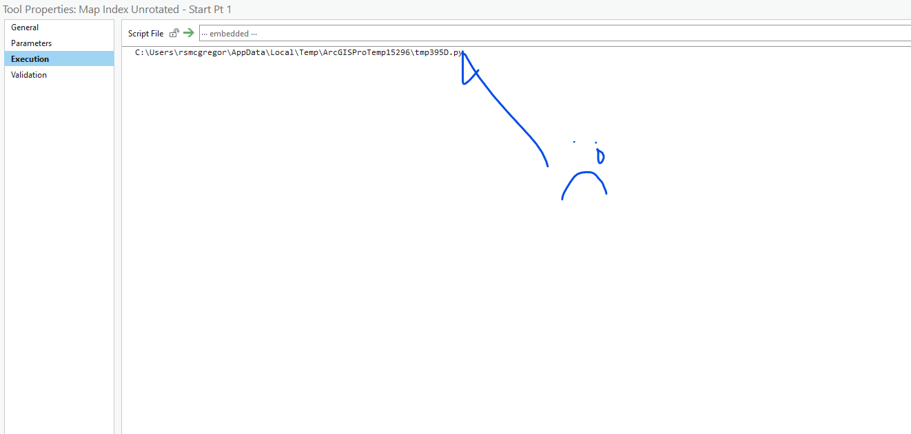

This happens with some regularity. The embedded script in a python script tool gets replaced by the filepath to to the temp *.py file for the code. I am refraining from using embedding scripts for now because of this but if anyone knows why this is happening, I would be most grateful. It is handy to use embedded scripts. Thank you,

Thank you, I have worked with embedded code a fair amount both within the 'properties' execution window and by opening the temporary .py file. Both work fine, and both will update the code, but sometimes the embedded code is simply replaced by the file path to the temporary file, and it's all over. I could have accidentally done this once, but it happens regularly and I'm not quite that absent minded :).
This is most definitely some sort of glitch, whether in ESRI's system or our own, I don't know. The topic explains how to update the code, but what I'm experiencing is not really a problem with the documentation, so not sure what feedback I could provide there. May open a support ticket at this point.
