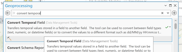

I have a similar issue with the date fields where they cannot be used under editor tracking due to error 001217, but they also cannot be deleted or thier properties edited - it would be quite easy to republish the layer without realising that the date fields are not recording any changes under editor tracking. I resolved it in ArcGIS Pro by using the 'convert temporal field' tool. I converted first to text, and then converted again to date. Then I deleted the old fields (which could not be deleted under 'fields') by exporting to a new feature class, and then renaming them during the export.
I hope this helps someone else!
