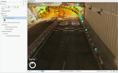

I'm working in scene (Arcgis Pro), with a point cloud and a shapefile. This shapefile (points) has its x,y,z coordinates and I would like to drag these points and place them in a specific position but I can only move them "flat" with the move tool.
So far I have not succeeded, any ideas?

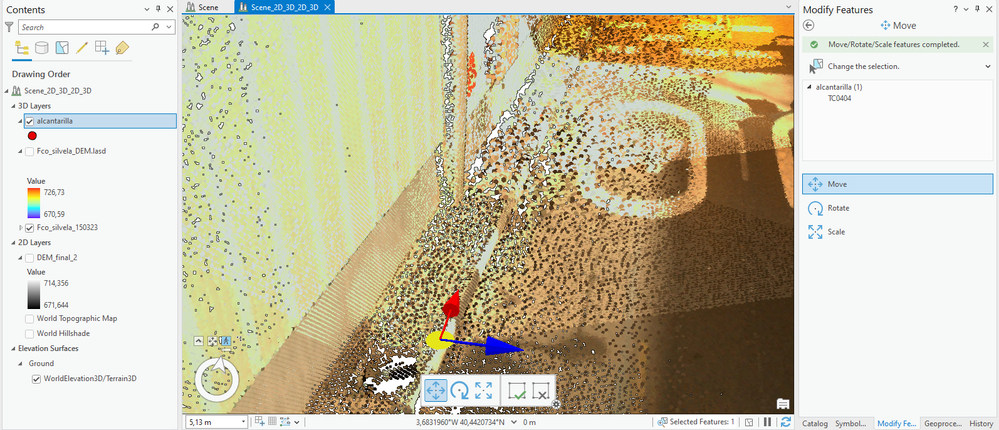

Hello @JaimeSáezPrat,
What version of PRO are you using? At least in 3.1 move activates this arrows (x,y,z) to edit a point coords. You also can edit Geometry's Z value using attributes table (geometry tab) when editing (although not ideal).

The version is 3.1. The problem is that it lets me edit, but only in the x,y plane. The Z plane is missing and I don't know how to move the points up. I'm interested in dragging them without having to put the coordinates in the attribute table.
Kepa
by Esri Contributor
That's odd. That behaviour is seen with non Z features, but I see the layer is under 3D layers... Can you provide a sample of your shapefile to check if it's something related to your data? Have you tried other Z point features from different data sources?
