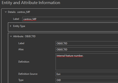

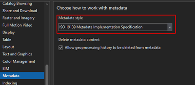

Hello @DanJanes,
Have you changed metadata style under ArcGIS PRO Options/Metadata?
As you can see from the attachments (in v3.0.2) it gets the name/alias correctly and automatically.
Snipaste_2023-03-01_20-20-35.pngSnipaste_2023-03-01_20-20-35.pngSnipaste_2023-03-01_20-21-15.pngSnipaste_2023-03-01_20-21-15.png
Regards,
DanJanes
I had tried changing the metadata style several times with no success.  However, your response caused me to go back and look again.   After clicking on "Synchronize" the fields now appear.
Kepa
by Esri Contributor
Glad it's working now. In case someone needs it "Synchronize" is on the Metadata tab when Catalog View is open.
