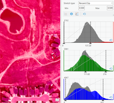

If you just want to change how it's displayed in Pro, there's a little chart button next to the "Stretch type" drop-down in the symbology pane. This gets you rudimentary levels adjustment, like this example where I turn the world into a cool nightmare zone:
I think you can use "Export as raster function template" from the symbology hamburger menu to get something you can use in further processing, but this is where I hit my limit on raster processing so I'll let someone else answer the tough stuff.

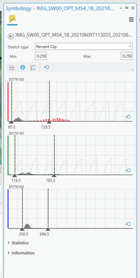

Thanks for that. Unfortunately, my screen doesn't look like yours ☹️.
Do I need to do something else? Sorry if I'm being dense.

My data is RGB satellite imagery which is why our histograms have such different distributions. In either case you can change the stretch type, edit the min & max values to present, and you can drag the little arrows at the bottom of each color band graph left & right: this is what shifts and compresses your colors. This is all real-time so try to manipulate all the different controls and options on that pane and see how that affects your map.

My data is also satellite (4 band) , but I can't seem to get it to appear anything like yours 😞
