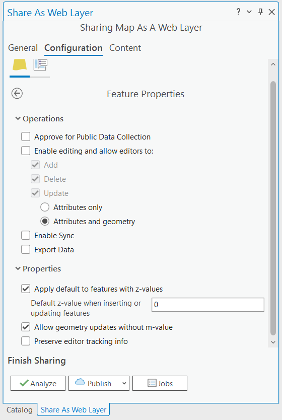

Hala_Ghareeb
You could overwrite the layer and make sure that you allow to edit the service without m-value
