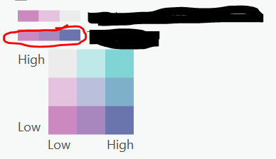

edit bi-variate choropleth map symbology
830
02-28-2023 06:28 AM
by Anonymous User
Not applicable
I'm creating a bi-variate choropleth map in ArcGIS Pro and would like to edit the symbology. When I rotate the symbology or set my own colours they display correctly in the map but one of the field colour ramps is incorrect. Does anyone know how to fix this? I believe the second colour ramp in my screen capture should transition from turquois to white, not pink to purple.
DavidPike
MVP Notable Contributor
Looks as expected to me.  Those are the monovariate (is that a word?) ranges. low to high for each variable.
https://developers.arcgis.com/javascript/latest/api-reference/esri-smartMapping-renderers-relationsh...
What's your reasoning for turqoise to white?
by Anonymous User
Not applicable
Oh I see what's  happening in my screen capture now. One of my variables is prevalence of low income.  I wanted to rearrange the colour ramps so that when variable 1 is low & variable 2 is high ((prevalence of low income) the polygon appears white (i.e. variable 1 is low, and income is low). I had to think a bit about what prevalence of low income really means - a high values mean that low income prevails, low values mean that high income prevails. Instead of playing with the symbology I just flipped the values around so that a low number = low income. ((PrevalenceofLowIncome * (-1)) +100)
