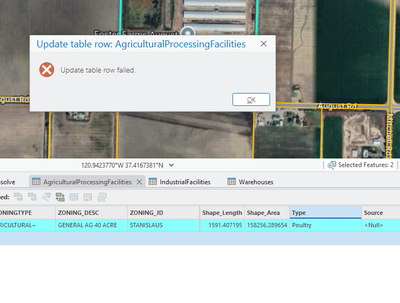

Here's an example:
I'm trying to update an attribute in the table after appending the highlighted feature to this feature class. When I hit enter after entering the value, I get the error message in the screenshot above. I tried clearing the display cache to no avail. Restarting the project reveals that the highlighted row was never even really appended to the table even though the append supposedly succeeded and the record was visible in the table (and I saved edits prior to restarting the project). Re-appending and then editing works fine (for a while).
This has happened several times today. I'm working on a beefy Azure VM that meets the recommended instance specs for multisession VMs for heavy users as documented here: Virtual machine sizing and user profiles—ArcGIS Pro | Documentation.
My gut is that it's a problem with my local profile but I can't figure out exactly what. Is there a max profile size recommendation for Pro?

I'm not aware of a maximum profile size limitation.  For the VM in question, have you performed a soft reset as mentioned higher up in this thread to see if that helps with workflows?  For the error message, what release of ArcGIS Pro are you using?  Is it a file geodatabase feature class?  Enterprise GDB?  Or a web layer to an online or enterprise portal?

I have. I had a support ticket open recently going over general optimization of our installation, with the goal of making sure everything was in order on the Pro side so I can press our IT department to dig deeper into some network issues that I think are affecting performance of Pro on the VMs. We did a bunch of troubleshooting of performance issues, network traffic, malware, etc., but we didn't touch on this particular issue. Maybe this one is specific enough that it will lead us to the source of some our issues. Thanks for your insights!
