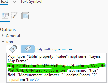

Original Layout with Dynamic Text displayed correctly.

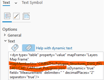

New Layout with dynamic text not displaying.
The mapMemberURI is still calling to the original layout/map when it should be

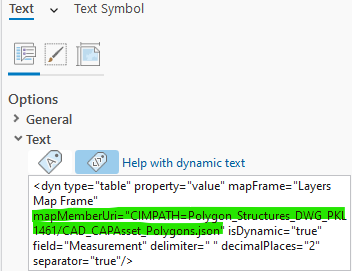

If the map frame is changed to a new one (not in the dynamic text options but in the layers map frame in the TOC) prior to pasting the dynamic text, this results in the dynamic text not updating when copied to the new layout.  However, if I change the map frame to a different one (in the TOC) and then change it back to the map frame I want the text to be displayed for, it updates.
While this is significantly better than having to manually update the dynamic text, it seems like it's still a bug.
