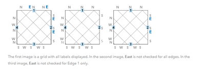

As for the labels, that is a common issue. ArcGIS Pro is able to better calculate and display the correct labels than ArcMap, which often means more labels appear on the grid. There is a solution to getting those pesky easting/northing labels to not appear on the opposite sides though! You can set directional labels to appear only on certain grid edges. Learn how here
