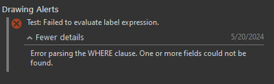

Hey,
I need some help out here..  I have a Postgres SQL that has all the features that my agency set it up and they also provide it with Symbology preset.
That layer has the feature show all over the USA within the Forest Service.  That layer has the Defintation Query set up as well.. The Defination Query shows me :
NOT NAME LIKE '%Valley'.
 I looked at the attribute table here and the Valley has all different terms such as this :
So I have the layer that shows Colorado and Kansas and when I use to clip tool.
Problem is that when it came out it is okay but I can see the error that shows....
And the new layer does not carry Definiation Query over from the Input Features.
Any ideas to why the Drawing Alerts shoed the failed label expression ?
DEAF_PROBERT_68
Honored Contributor
Hey, I just discovered that in the SQL in the Labeling section has SQL there on that orignal PostgreSQl layer.
However, when I exported , I set to two states to create output the same as an original layer.
So maybe that will solve me this problem.
Thanks
DEAF_PROBERT_68
Honored Contributor
Hey Never mind I did research and found this issues that  still apply to my side...
https://community.esri.com/t5/arcgis-pro-questions/error-in-feature-class-label-sql-where-clause-whe...
My agency has not upgreade from 3.2.2 to 3.3 yet....
