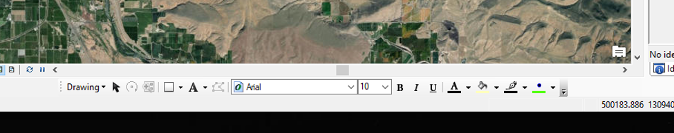

I have been looking for the Draw toolbar from ArcMap in ArcPro.  Am I missing something, or is it not included?  I use that toolbar all the time when making maps and graphics.

Nope.  I mean the draw toolbar from ArcMap.  Please see the attached picture.  You can draw vectors that are not shapefiles, as well as quickly edit text. I use this function to quickly draw lines and polys when I am drafting shapefiles.

https://community.esri.com/ideas/10410 is in the product plan right now.  It will not be in Pro 2.5 when that releases next week, but I believe we'll see a graphics layer experience in 2.6 mid-year.
