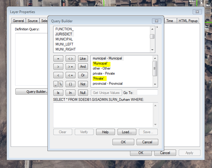

In ArcGIS Pro everything seems OK, but when you look at the data in ArcMap you can see that ArcGIS Pro is actually adding the 'Description' into the field and not the 'Code'.  For example, it is entering in 'Municipal' instead of 'municipal'.  In ArcMap, looking at the data through Query Builder you can see the problem it causes.  The highlighted field are actually wrong values.

To fix the problem you could use the Calculate Field tool with something like this:
fix_values(!field_input!)
def fix_values(current_value):
	if current_value == 'Value To Fix One Description':
		return 'FixedValueOneCode'
	elif current_value == 'Value To Fix Two Description':
		return 'FixedValueTwoCode'
	else:
		return current_value‍‍‍‍‍‍‍
Best to calculate to a new field to ensure it works as expected first.
