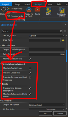

I have solved this myself for both ArcGIS Pro and Python scripting.
Within ArcGIS Pro, instead of going to the tool-specific environment settings, go to your Environments section under the Analysis tab. From there, you can toggle some settings to fix this. For the Domain/Subtype descriptions to properly export via Pro and Python, I needed to toggle the checkboxes for "Transfer Geodatabase Field Properties" and "Transfer Field Domain Descriptions".
My python script required the "Transfer Geodatabase Field Properties" setting to be set to True regardless of the "Transfer Field Domain Descriptions" setting.

This only works for tools that honor the "Transfer field domain descriptions". For instance, it does not work for Intersect operations.
