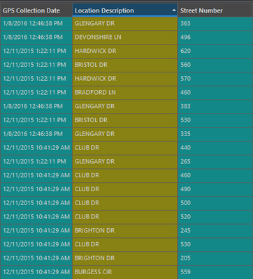

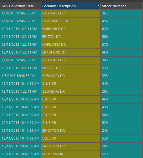

Hello,
In ArcGIS Pro 3.0 I am attempting to simply sort a field by ascending/descending order. The field will not sort. This is the first time I have experienced this issue. It is a text field of a hosted feature service  layer that I am working on within Pro. There is a "street listing" domain associated with the field. Other domain-enabled fields within the same layer seem to sort correctly. Although, there are different layers within the same service, and with the same domain that also do not sort correctly, so I am thinking it may have something to do with the domain. I have attached a screenshot of a selection with the Location Description field sorted, it does not change whether I sort ascending or descending. Any thoughts on why this glitch is occurring?
Any advice appreciated,
Dan

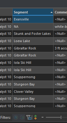

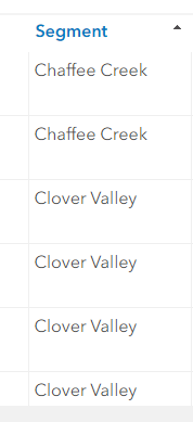

TiffanyStram
I am also having this issue in ArcGIS Pro 3.2.1.  If I sort the field in ArcGIS Online, it sorts correctly, however it will not sort in ArcGIS Pro.  Other fields in this hosted feature layer do sort correctly in ArcGIS Pro.
