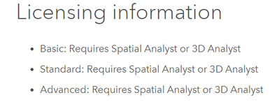

You would require a 3D Analyst or Spatial Analyst extension for ArcGIS Pro.
Slope (Spatial Analyst)—ArcGIS Pro | Documentation

You get exactly what you buy. ArcGIS Pro Basic/ Standard/ Advanced doesn't come with any extension.
The extensions can be procured separately or bundled with the core Desktop licenses (e.g. ArcGIS for Personal Use license is a bundled product with ArcGIS Pro Advanced and 10 extensions and ArcGIS Online subscription; but it's for non-commercial purpose only). You could reach out to your local Esri distributor for more information.
You can buy just the extension.
