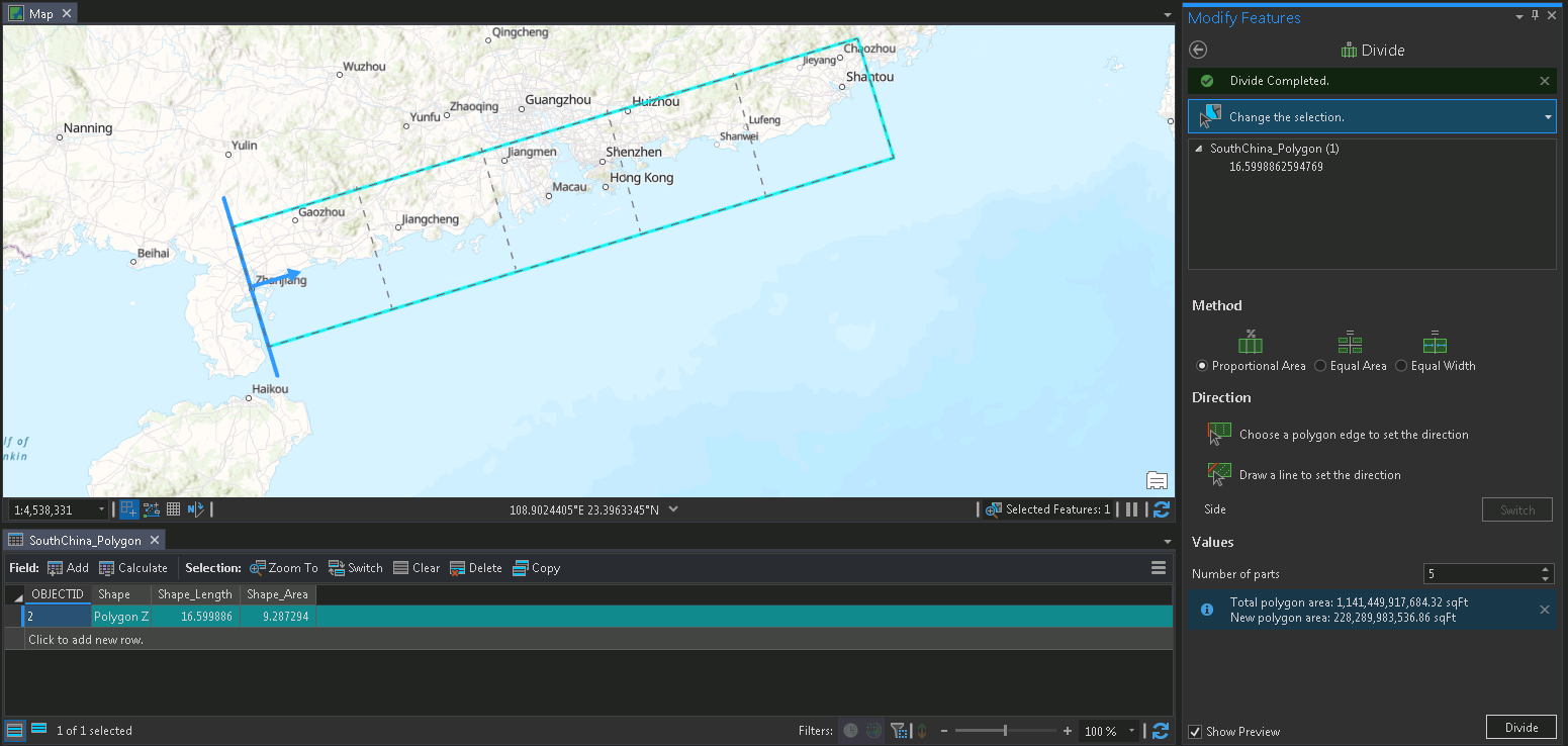

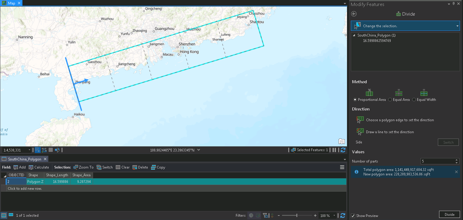

I'm sure I'm probably missing something very basic, but I created a rectangular polyon along the coastline of southern China.  I then went to the Modify Features - Divide tool.  I was able to select the polygon, then select the edge to set the direction of the divide, selected proportional area, and increased the number of parts to 5.  The preview below shows this well, and is exactly what I want the tool to do.
However, I hit the divide tool, it runs and says "Divide Completed", but it doesn't seem to do anything.  No new polygons are created, and I cannot save the edits or anything?  The existing polygon attribute table continues to show just the single original rectangular polygon.  I checked the project geodatabase and there is nothing new in there either.
Tool setup shown
Shown after clicking Divide button - now showing "Divide Completed" in the upper right

    • I created a feature class using the new feature class option after right clicking on the project geodatabase.  I specified the feature class and gave it a name.  I then added it to the current map, and went to create tools choosing the rectangle option.  I drew the rectangle that is shown by dragging with my mouse.  I then saved the edits before going to the Divide tool and trying to split this rectangle with the method described previously.
  • Does Check Geometry return any problems with the data? - Check Geometry—Data Management toolbox | Documentation
    •  Ran check geometry and it shows no errors.  (there are 4 vertices of the rectangle so a fairly simple topology)
  • If you take the same polygon feature class and add it to a map in a new project, does Divide work there?
    • After posting I created a new project, creating a similar rectangle within a fresh geodatabase and ran into the same issue.  Also, I tried the "Split" tool just to see what would happen, and this tool works fine.  I drew a line from one side to the other of my target rectangle, clicked the run button and my one polygon became two both on the map and within the attribute table.
I just tried it one last time with a new project and a new rectangle, with the same result.
Thanks again for any other thoughts you may have.  I'll have to go to Esri help directly I'm guessing.
