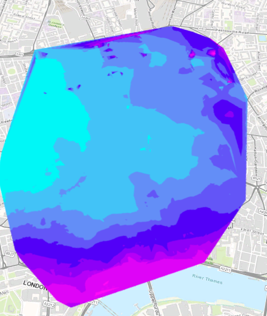

I am working on a project to identify buildings affected by low pressure in water supply. In ArcScene, it is quite easy to visualize and extrude buildings using height data and creating tin from model pressure data. The buildings which come on top of the pressure tin are affected buildings due to low pressure. I am using ArcGIS Pro 1.3 and haven't figure out how to display pressure surface layer in 3D either as Tin or in some other format. On similar subject it was mentioned by ESRI staff that Tin can only be added as elevation source but not as 3D layer. I was wondering is there any progress on this feature in 1.3 or any alternative way to mimic pressure surface layer in ArcGIS Pro.

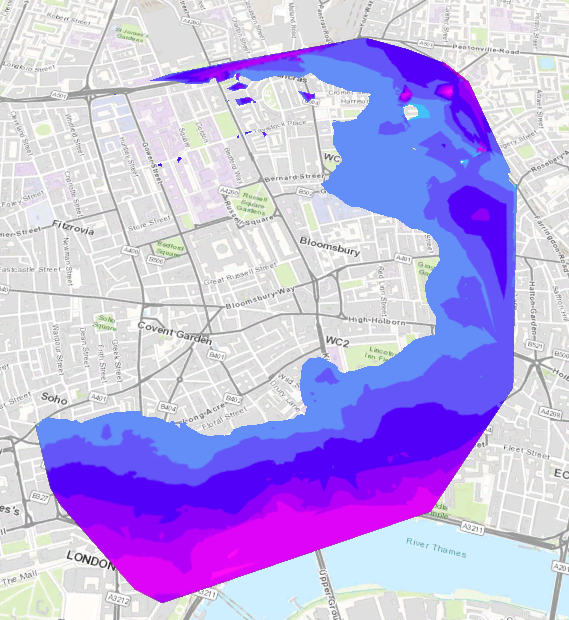

It works now. But I ran into another problem. After switching to option "Features are on custom elevation surface" through layer/Elevation property, more than half of the tin disappeared. What do think could be the issue? See below two images one before applying custom elevation and one after applying custom elevation.
JeremyWright
This is because your surface is conflicting with ground (this is sometimes called "z-fighting").  You can either offset it by a large enough amount to get it above the ground, or remove the ground elevation source (so it is flat).
you didn't have these problems in ArcScene because Arcscene doesn't have a ground.
